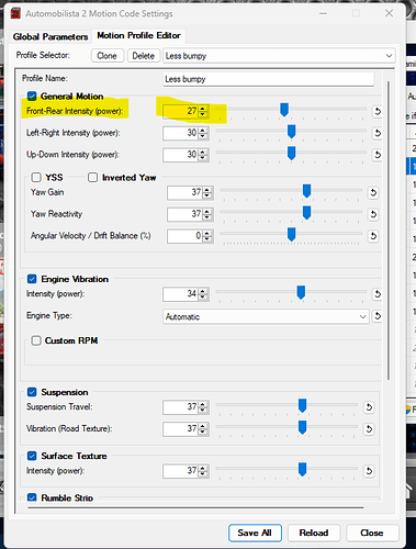

AMS2 is great with Dbox, but the shifting surge is pretty aggressive especially when in a turn it moves you too much. Can the team add a slider for shift effects as it has been implemented for the other sims? Way too aggressive for me and I love hard shifts, but dang this is intense.
I second this^^^ Love AMS2+ D-Box, think it is one of the most immersive sim experiences, but I also feel it would be great to adjust the shifts independent of say front/rear movement intensity or speed or the other larger effects already so well implemented in AMS2 with D-Box.
I 3rd this, please make a way for us to adjust the shift on our D-Box systems.
Would be great if they can separate the shift effect % for all the game profiles!

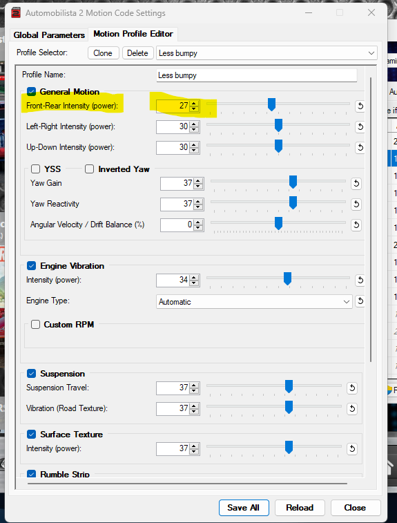

Hey guys. I did find a work around. You can turn down the /general motion Front-rear Intensity (power) to lower the shift effects. Setting 27 feel good to me with no more instant head ach. lol
